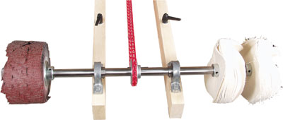

In order to save my just rerpaired shoulder I'm going to break down and buy a buffer and give up all the micro mesh sanding on my varnish finishes. Does anyone have experinece with the buffer StuMac sells? How about compared to the arbor that Klingspore sells, which looks like it offers more working room but would take more work to set up?

I've got the Stew-Mac Arbor/buffer, it's a tad tight between the wheels and the stand, vibrates a bit too much, but it works fine for me.....beats the heck out of doing it by hand! If you have to buy a motor to go with it, I think maybe another $100.00 and you could get something a little more refined.

The arbor doesn't cause the vibration, Greg, it's the buffing wheels being out of balance with each other. Balance them by marking both of them with a marker, drawing a line at the same place on each. Spin it to full speed, and note how badly it shakes. Stop, loosen ONE wheel a bit, and turn the wheel 1/2 turn on the shaft, putting it at 180 degrees from the marks on the other wheel. Spin it again, and note if it is better or not. Now, loosen it again, and turn it halfway again, so that it is only 90 degrees to the original wheel. Spin it, and note how it is. If it is better, still, keep fine tuning it from here, going back and forth in small increments. It it's worse, go back 180 degrees, and start to fine tune from there.
In about ten minutes, you'll have that sucker balanced nicely, with little shake left.
The above needs to be done on any buffer, regardless of who makes it, BTW.
The only other factor that will cause a bad shake is a belt going bad, and/or a belt that is too loose. Oh, and having a light weight stand, or having it bolted to a small, light/weak table also accentuates any shake. Bolt that sucker to something solid.
As to the space between wheels, if you wish to buff complete guitars, it is very tight, bordering on dangerous, but for bodies and necks seperately, there's plenty of room.Mario38965.8946180556

the Klingspor arbor is a great way to go. It gives plenty of room end-to-
end, has a more substantial arbor (1" I think), easily takes 14" buffs
doubled or tripled, and doesn't take very much to set up. Any 1/2 hp
motor will do. I have never experienced any significant vibrational issues.
I haven't used it, but the S-M arbor looks very narrow to me and won't
allow you to use larger diameter buffs, which give you a lot more
clearance when buffing. I think it would be so easy to bump a guitar
against the center section with the S-M unit while moving the guitar
around. The Klingspor is cheaper too.
Craig S.

you can find it on their web site, but it's hard to find. The part number is
CL34000 and is called a 32" MANDREL W/ 1" SHAFT KIT. It looks like
this:
